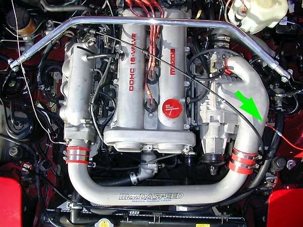

1. Jackson kit come with a 0.5mm jet.
2. It is a 4mm OD line.
3. The miata kit come with a drilled dummy manifold, the position Jackson recing recommeded it after extensive testing by the man himself.
4. You can tap into here:
