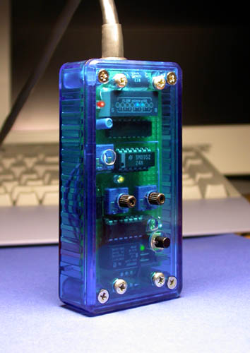

Thanks for the MAF information. I guess it means when the MAF reads 3.8V, the boost is at 13psi?
I can't remember at what boost the WI triggers. Can you?

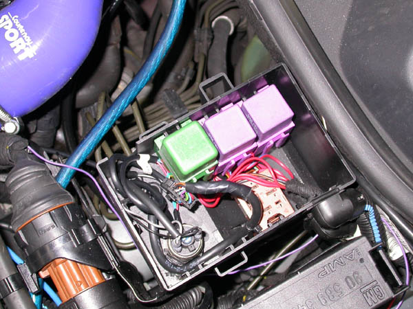

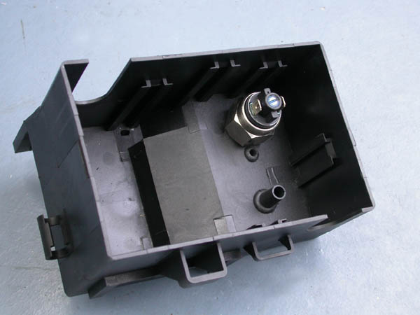

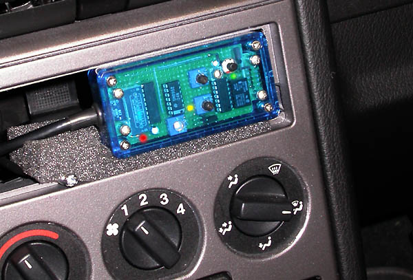

I have a few pictures here I took a few days ago.
http://www.aquamist.co.uk/forum/gallery/astra/1.jpg
http://www.aquamist.co.uk/forum/gallery/astra/2.jpg
http://www.aquamist.co.uk/forum/gallery/astra/3.jpg
http://www.aquamist.co.uk/forum/gall...tra/Dash-s.jpg

The MAF threshold is between 2.6V to 4.85 volts.
Each click of the trreshold potentiometer is about 0.11V.
11 clicks will arrive at the WI triggering point (3.8V). If you have a moment, could you advance the threshold potentiometer by 10 clicks (not 11), if things work as intended, the yollow led will come on almost immediately after the MAF converter is enabled by the system1s WI.
Things are looking good.
MikeWarner 22-01-2006 01:23 PM
Richard - I thought the threshold was between 3 and 5v. It takes 8 clicks to get the lowest voltage the WI triggers with.
