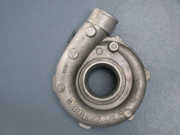

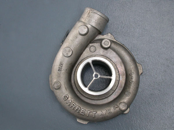

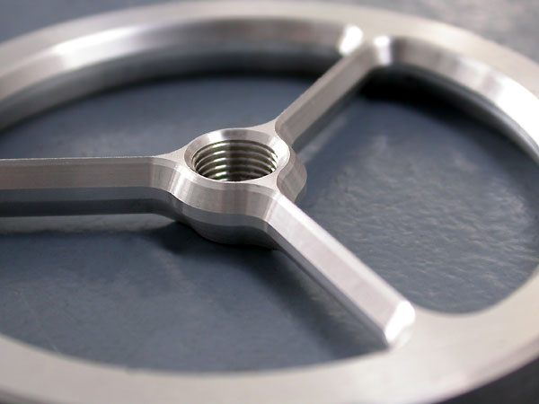

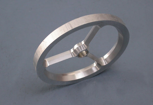

To day, we had a chance to experiment on fabricating a holder for pre-turbo injection.
Haven't yet finalise the method of clamping.

http://www.aquamist.co.uk/forum/gallery/precooler/1.jpg
http://www.aquamist.co.uk/forum/gallery/precooler/2.jpg
http://www.aquamist.co.uk/forum/gallery/precooler/3.jpg
http://www.aquamist.co.uk/forum/gallery/precooler/4.jpg
http://www.aquamist.co.uk/forum/gallery/precooler/5.jpg
JohnA 05-08-2005 07:15 PM
very interesting.
How about an aluminum fitting to replace the hose sitting in the pressurised airstream? Would the standard bits survive the conditions?
Richard L 05-08-2005 07:32 PM
Originally Posted by JohnA
very interesting.
The air pressure will be less than a bar. The intention was to use two jubilee clipd, one to clamp the disc bracket and the other clamps the silicon hose to the turbo flange.
We might try to make a lip to go over the turbo flange (interference fit). This bracket will be tested on a twin turbo skyline about 800 horses. The car in concern has inlet heat soak problem becuase it has pot injection fitted.
The goal was to achieve 900 horses with twin 400bhp turbos - it will show if the pre turbo idea work of not. We have found that running 3 boost yields less power than 2 bar boost - nearly 70 horses loss!!!
