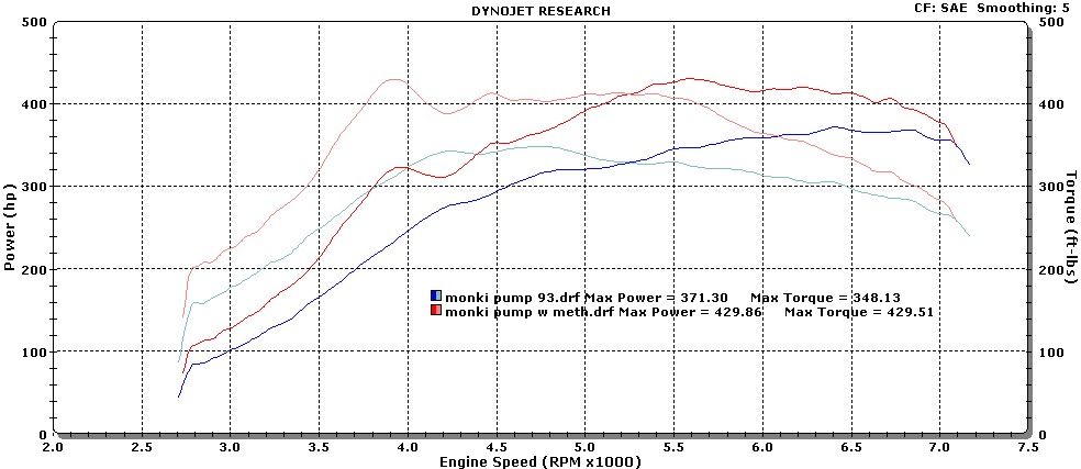

finally worked out all the bugs on the dyno and got tuned again (third time in two months) and here are the results. this is on an 08 wrx with a borgwarner EFR 70/64 IWG twin scroll turbo and full-race twin scroll kit.
pump @ 20psi peak.
pump + meth (50/50) @ 29psi peak.
http://i687.photobucket.com/albums/v...y/baafb535.jpg
you gotta love this stuff, i mean just incredible results!
