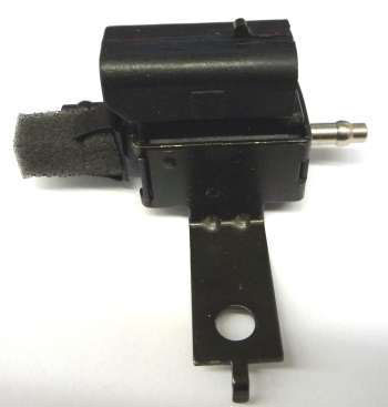

http://www.aquamist.co.uk/HFS4/wirin...solenoid-s.jpg
- Top picture ............ ecotec product (from link)
- Bottom picture .......... googled. It has three port.
I think they are the same valve. One with dust guard
Can you tell me where the ports is connected to:
a ...... assume to atmosphere?
b ...... ?
c ...... ?
Dust 06-01-2014 06:55 PM
Re: LSJ Cobalt/Ion Redline ECU pinout
C is atmosphere, hence the dust guard in first pic
A connects to the intake manifold and B connects to the bottom port of the "SC bypass actuator". The electric connection on "A" side faces the back of the car. The coworker that was supposed to help me with the car took off before lunch so it will be after work before I can tell you the connections, although from the pic it seems like there is only two.

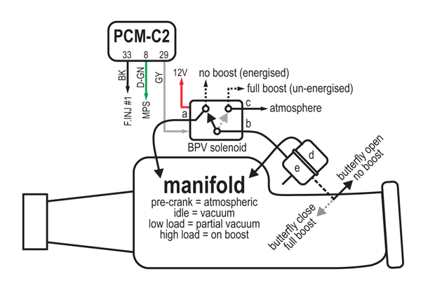

Please check the diagram below is correct.
http://www.aquamist.co.uk/HFS4/wirin...schematics.gif

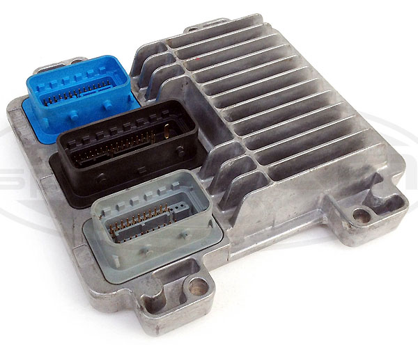

Is this the correct PCM?
http://www.aquamist.co.uk/HFS4/wirin...info/pcm-s.jpg
Dust 07-01-2014 02:44 AM
That looks like it.
Between the fuse box and BOV. LSJ, but turboed. Leaves more space in that area to see it.
https://fbcdn-sphotos-c-a.akamaihd.n...42703464_n.jpg
This is the next generation of the engine, but it has a much better pic of the PCM.
http://i200.photobucket.com/albums/a...0/IMAG0410.jpg
Look in the middle of this picture at the blue piece. That is the elctric connection for the solenoid above.
http://farm9.staticflickr.com/8484/8...4d4b6966_b.jpg
http://cobaltss.net/gallery/files/1/...s_engine_2.jpg

And should your first 29 in the diagram you made be 33?
Richard L 07-01-2014 09:29 AM
Sorry, made the correction. I will make the H4/LSJ wiring drawing as soon as I can.
