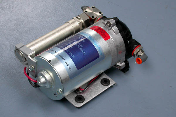

I this stage I just want to share surge arrestor results. I had one made from aluminum about 270cc capacity. It is membrane-less type.

According to test results, having surge arrestor is beneficial to power consumption and pressure variation reduction. Especially if you have proper (membrane type) or air filed arrestor it will make a huge difference. In my case it removed 90% of pressure pulsation and reduced power consumption by as much as 20%. Not to mention all the hydraulic system benefits such as increased flow and reduced stress of the system.
http://www.audizine.com/gallery/data...restor-med.jpg

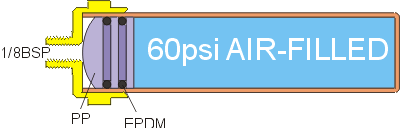

I belive you have include a 22cc accumulator on your order already. It should be with you anytime now. Those accumulators are air charged, see diagram:
http://www.aquamist.co.uk/forum/806-408.gif
We have always install an accumulator on Shurflo pump based systems: Here is our standard set up:
http://www.aquamist.co.uk/forum/shurflo45.jpg
Charging up the accumulator is only take a matter of seconds, especially the small 22cc one. The think the advantage far outweighes the disadvanages.
