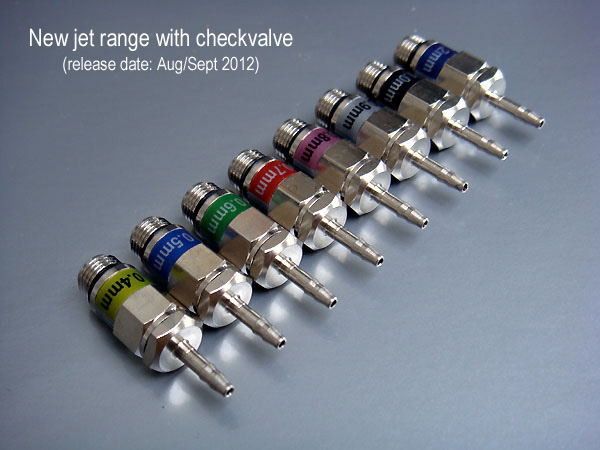

As promised, here is a preview of the jet with internal 15 psi checkvalve. It will be available from Aquamist only within 2-3 weeks, but only with limited supply until full production.

Hey Richard i have a few question for ya. First do you have the wiring diagram for the mazdaspeed 3 if so can you shoot me a link or email for the setup. I will be getting this kit in a few days. Can i have the preamp soldered to the 2.5 and the bar map set for the 2.5 or 3 whichever is best ill be hitting about 19psi boost. Also are the kits coming with those new nozzles with the check valve in them?

3) The kit comes with standard nozzles (no checkvalve). There is no advantage to use checkvalve unless the application demands it.
