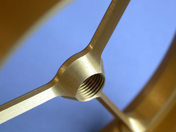

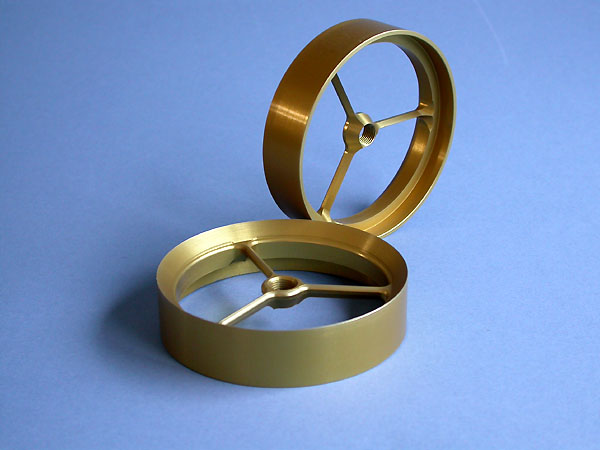

Richard, just wondering if you've made any progress on these or if you plan on releasing them any time in the future. If so, you've got one interested buyer here! Also, what diameter(s) do they come in?
I'm dead-set on successfully using pre-compressor injection, just don't want to be replacing the compressor wheel every year or so. My setup as it stands now is very close to spraying directly into the compressor wheel, but there may be a bit of spray pattern to intake pipe collision as the nozzle is a bit farther away from the wheel than I'd like.
