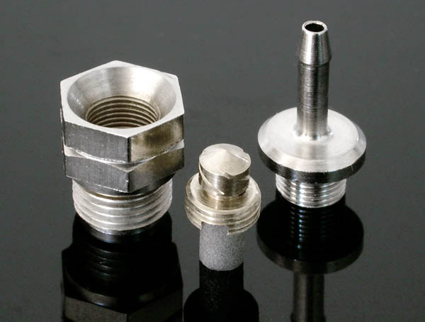

1. We manufacture a high pressure 130 micron inline filter (Picture below)
2. It is poossible to supply a jets with a 25micro internal filter. But it is only available on a 0.3mm jet. flowing about 100cc/min. We can put the same filter in a larger jet but the filter and clog up within a few months unless you put another 30 micron between the tank and pump. (pictiure below 2/3)

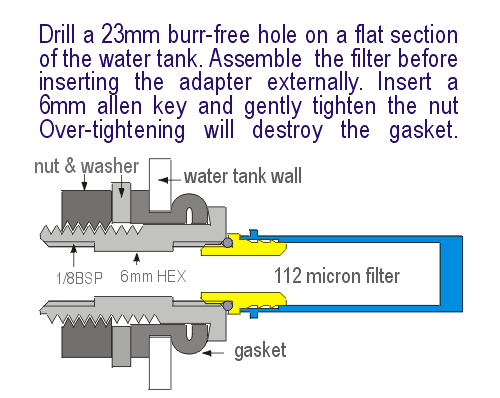

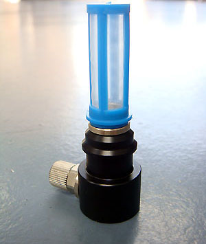

3. The HFS-4 comes with an in-tank 112 micron filter (picture 4/5)
