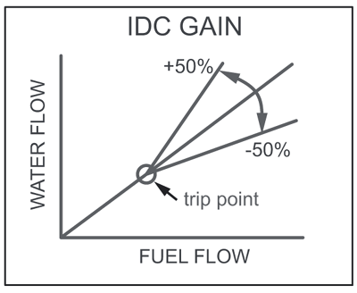

Also had a chance to play with injection settings, turned the threshold setting down a bit (30% IDC or so) and also dialed gain a bit higher. Noted that the maximum flow is not significantly affected with a gain setting - presumably due to my small jet size. Am I correct to assume that with a small jet size turning the gain all the way up would result in higher midrange injection (relative to IDC) but have almost no effect on the top-end injection (as it is the jet size that effectively caps the water flow there)?
If the above is correct I would assume that putting the bigger restrictor in but leaving the small jet would make the a.m. effect (non-linear injection with higher flow to IDC rate in midrange) even more pronounced, correct?
The gain trimmer (probably badly notated on our part). We should have called it "F-idc% re-scaling trimmer". A bit too long to put into the limited board space underneath the trimmer.
For example, if your maximum injector opening is 50%. increase the gain by x2 will allow a full linear meth flow progression (100%)
But if you set gain trimmer to x4. You will reach 100% meth earlier. More throttle will only result in the same 100% flow.
http://www.aquamist.co.uk/HFS3/GAIN.gif
