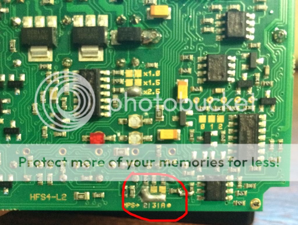

I was looking at the manual and comparing it with my board. Is the soldering done wrong here?
http://i394.photobucket.com/albums/p...psqzzfsxtz.jpg
http://i394.photobucket.com/albums/p...psiuzh72jh.jpg
