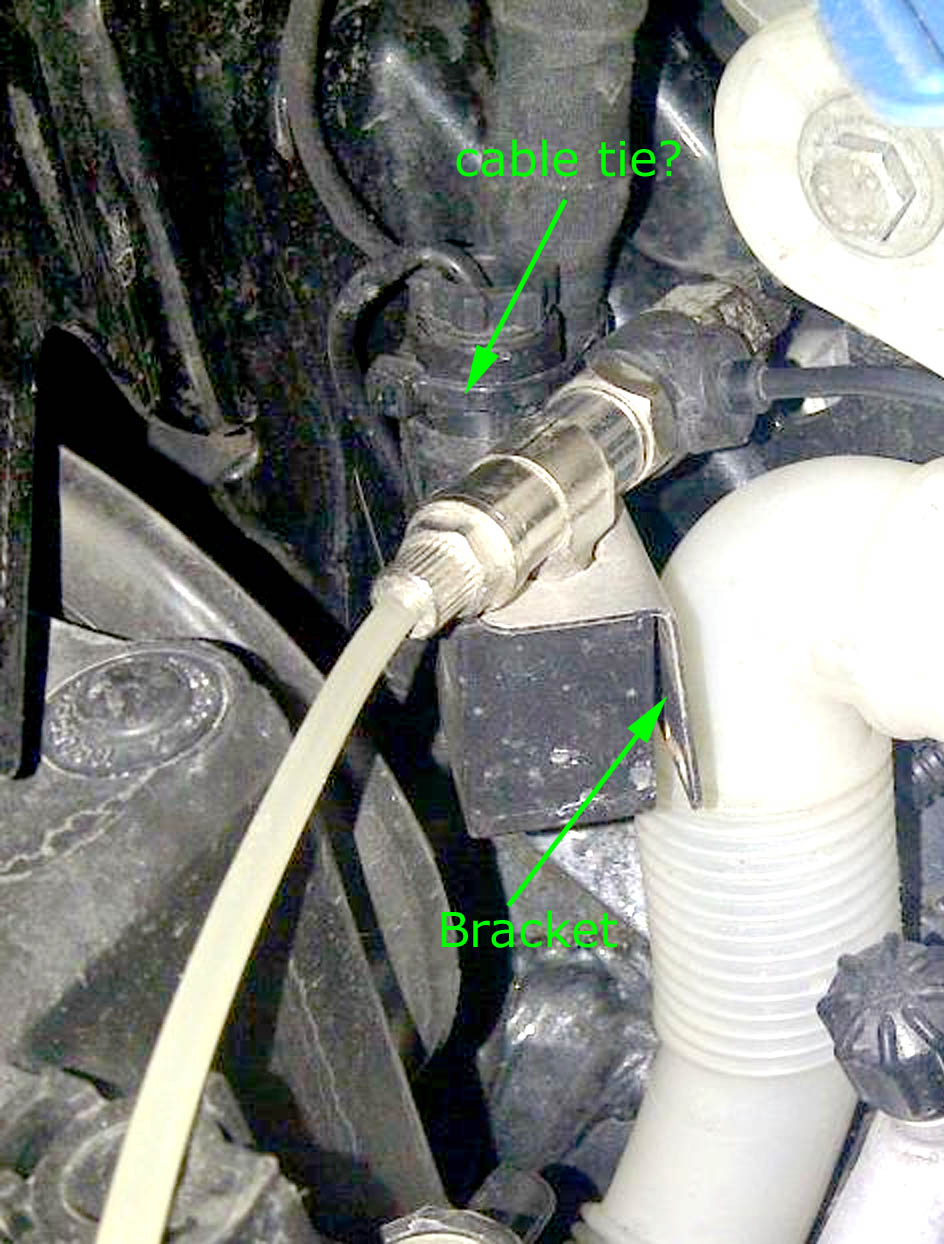

On a closing look, the FAV is held in position with a cable tie rather using the bracket supplier with the system. It can be that secure as far as vibration is concerned. Bolt on the FAV properly and see if it improves.
Putting in a new sensor will not improve the situation.

here a picture of my previous setup :
http://i62.photobucket.com/albums/h9...ps452fbbc2.jpg
I tie the fav to the harness away from all the vibration after you tell me
"Is it possible for you to unbolt the FAV cluster and rest it on something soft and see if you see false reading. It is done on idle.
I try to establish what caused it. Mechanical vibration or electrical signal. Un-clip the sensor and see if the gauge still registers something."

after looking at your pic hotshot the metal bracket on the fav assembly is touching the windshield fluid washer reservoir tube. That tube vibrates very much, especially with the spm engine mount you have.

I try another different setup its better but I still have some false flow reading from time to time.
