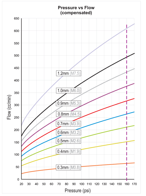

Since I plan on using the hfs-4 mainly as supplementing the maxed out rs4 injectors in my a4 fsi, what is the max size nozzle I can run to get the most out of the system. I read the pump is capable of flowing 1600cc, so would 4 nozzles running 400cc each be the best? Or should I add a 5th nozzle after the intercooler for cooling purposes as well? I want to optimize the system for fuel delivery to increase power as opposed for cooling purposes how should I go about this? Does this affect the water/meth ratio I should run? I tried searching but not much info on direct port, Thank you.
Richard L 22-02-2012 11:27 AM
Re: HFS-4 Q&A, application for your engine...
The system is capable of sprayiong ~1300cc/min with the standard valve (806-239B). We can supply a 806-239 valve for ~1600cc/min. It appears you need to run 4x 0.8mm jets + a little bit of head room for the 5th injector. Not a problem.
If ypu run twin valve, the system is capable of 2500cc/min. Requires larger hose ID between the tank and pump. 10mm ID will do nicely.
Here is a chart for the jet vs flow:
http://www.aquamist.co.uk/HFS4/jetrate+M.gif
