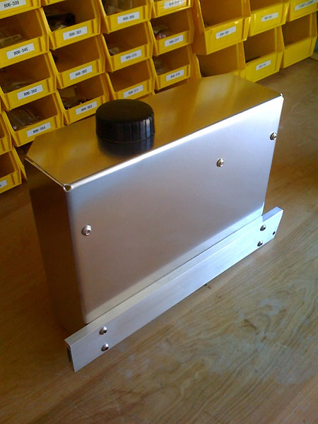

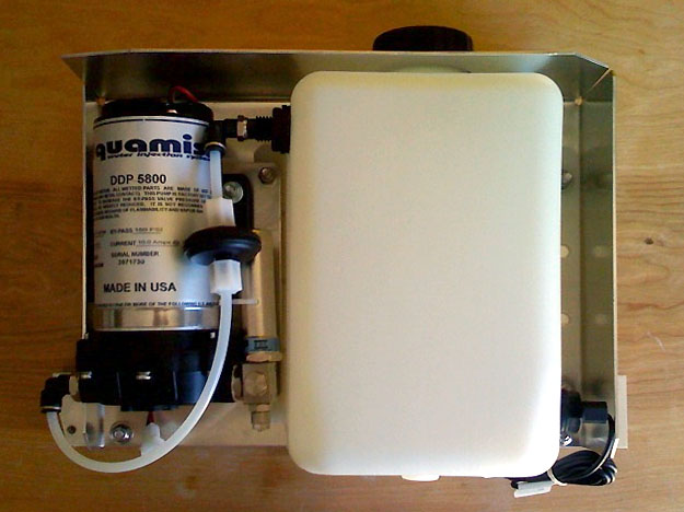

One of our dealer - howertonengineering.com keeps a very good range of flambleau tanks. They also have stock of brackets that will hold the tank and pump in one neat location - 4-quart tank. but available in 5 & 6 quiart also:
http://www.aquamist.co.uk/HFS6/tank/h7.jpg
The shape of the tank helps to prevent water surging. More pictures at different angles.
http://www.aquamist.co.uk/HFS6/tank/h1.jpg

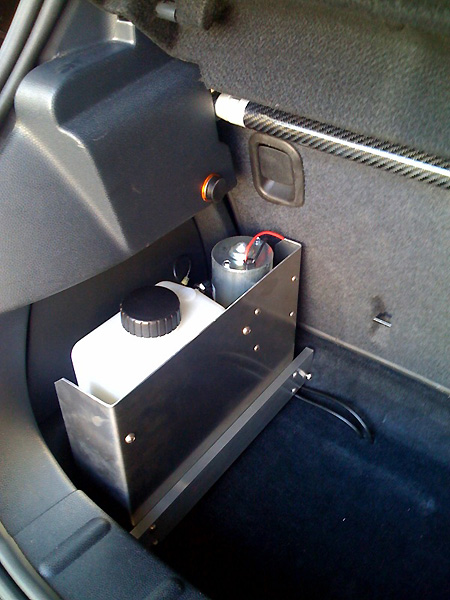

It is possible to double the capacity by bolting another tank back to back of the first one.
The cross bar is designed for BMW mini installation. Only takes les than 5 minutes to installer. Jeff (Howerton) is very clever at fabricating work as shown below (without top lip):

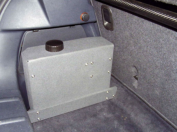

http://www.aquamist.co.uk/HFS6/tank/m1m.jpg
With top lip and texture coated.
http://www.aquamist.co.uk/HFS6/tank/m13s.jpg
