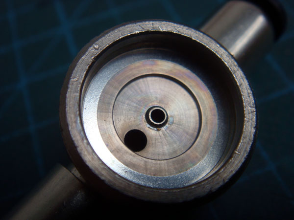

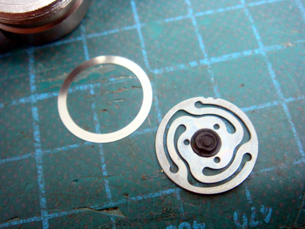

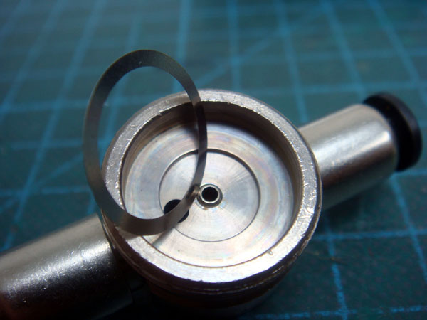

If you ground the brown wire and the system does not go, it is probably due to system pressure is sety too high. The system is set to 100psi from the factory. This is done by calibrating the 806-162 pressure switch.
If the system pressure is too high, it will stop the HSV from opening. There is a small washer inside the HSV, please remove it carefully and keep it somewhere safe. Reassemble HSV.... See picture.
http://www.aquamist.co.uk/forum/gall...ppard/shim.jpg
http://www.aquamist.co.uk/forum/gall...d/shim-off.jpg
http://www.aquamist.co.uk/forum/gall...ard/spider.jpg

Hi richard, I have remove the small washer and the system GO!
Wery good!

Richard L 17-11-2009 10:21 PM
Can you take a picture of the rubber seat? It is in the center of the spider. If there is a dimple on rubber surface may be damaged. What mixture are you using? water/methanol?

Richard L 17-11-2009 11:53 PM
I think the indent on the rubber is the problem I will send you a new spider. Can I post it to you?
