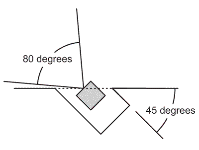

Richard L 27-03-2010 09:36 AM
Re: fail safe for centrifugal supercharger
It is always possible to plug it up with the supplied jet adaptor plug. Ensure the the full spray pattern is not affected by the angled installation.
http://www.aquamist.co.uk/forum/spray-angle.gif
Please let us know how it performs as it is.
