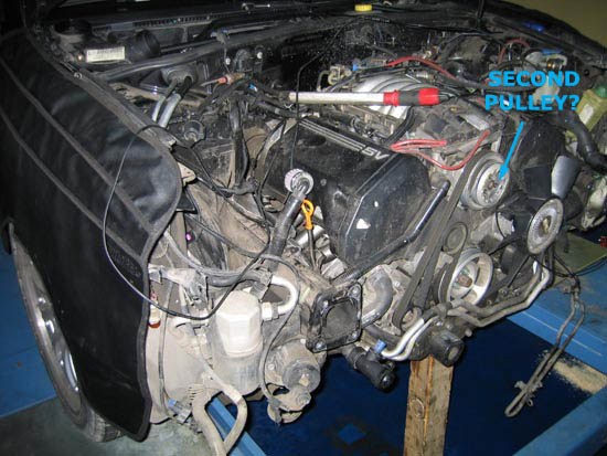

Can these pics help to better explain where should be extra pulley fitted?
http://www.foto.rtd-universal.ru/n/images/IMG_0202.jpg
http://www.foto.rtd-universal.ru/n/images/IMG_0203.jpg
Richard L 01-04-2004 01:47 AM
Try to draw the second pulley in front of larger one.
http://www.aquamist.co.uk/forum/pulley.JPG
You will also need to put another pulley in front of the supercharger or move the s/c forward. In most cases, you should be able to obtain a longer s/c nose.
Nenad 01-04-2004 08:03 AM
Good idea, didn't tought that way at all.
