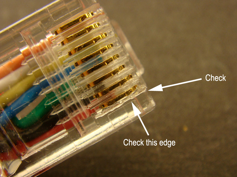

It is quite easy to have a partial short between the strands of the flat black cable, could be badly crimped or flexed too much during installation.
Anyway, perhaps it is better to make a new cable, just cut off the two plugs and crimp on new once. Make sure the plug/plug orientation is as following (colour is not important)
http://www.aquamist.co.uk/HFS6/RJ45-gauge.gif
And check for damages:
http://www.aquamist.co.uk/forum/gallery/HFS6/conn1.jpg
http://www.aquamist.co.uk/forum/gallery/HFS6/conn2.jpg

This cable is terminated with RJ-45 connectors right? Im not 100% sure because they look wider then normal.
blk01s4 04-01-2011 01:17 AM
Re: New HFS-1 system not working
After close examanation of the new cable there does appear to be damage from the crimping tool. I did count the wires/pairs and I will recrimp an RJ-45 to the end of the cable and report back.
blk01s4 04-01-2011 02:07 AM
Awesome, after recrimping the cable that had the bad end now it works I can dial the SC around and the bars move. But, still no dice on moving the WL to get the "B" light to turn off once SC is dialed in. I noted the version of the board I have is V10-L. Does the version of the board I have support doing this? The instructions I have say V10-W on them so im starting to wonder.
