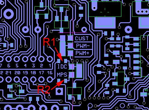

Richard L 22-07-2013 11:12 PM
Re: HFS3 Ver 2 onto 8L Audi S3 1.8 20VT
R1 = 27K
R2 = 47K
R2/(R1+R2) is the ratio of IDC% (~63%)
http://www.aquamist.co.uk/HFS3/PI ratio.gif
dscline 22-07-2013 11:33 PM
Awesome, thanks! So if I understand correctly, 27K for R1 and 47K for R2 are the stock values? If you wanted to change the ratio to 50/50, for example, could you simply replace the stock R1 resistor with a 47K resistor (or R2 with a 27K), or is there also a requirement to keep the total resistance (R1+R2) something close to 27+47 (74K)?
Richard L 23-07-2013 07:41 AM
As long as the total valve is around 60-80K, it will be fine.
Don't forget to link MPS as well.
