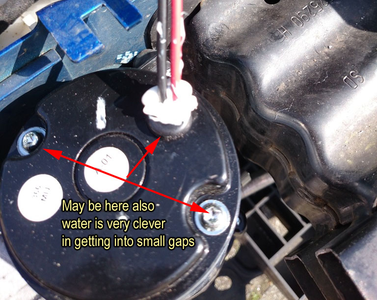

Rickk207 13-04-2014 04:31 PM
Re: peugeot 207
http://img62.imageshack.us/img62/1457/mm4f.jpg
http://img849.imageshack.us/img849/4340/c1z5.jpg
http://img829.imageshack.us/img829/4005/r4ky.jpg
http://img196.imageshack.us/img196/1037/a1hy.jpg
Richard L 13-04-2014 07:55 PM
Re: peugeot 207
You have been very careful, you cannot completely prevent water getting in over a long period but at least for a year or two , you are quite safe. What about putting a plastic cover over the top of the pump also?
I strongly suggest you apply more sealants in these areas:
http://www.aquamist.co.uk/forum/seal.jpg.
Rickk207 13-04-2014 08:32 PM
Re: peugeot 207
Thanks for the tip.
Next weekend will do some more sealant.
