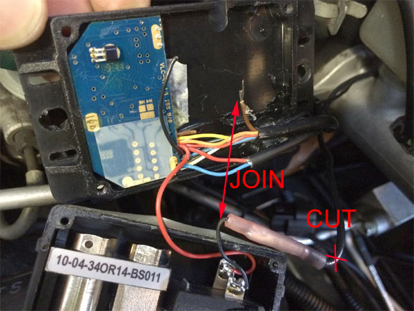

post a picture before I get confused. Mark the wires in question with numbers.
vsgts14 26-08-2014 06:27 PM
Re: hfs6 problems
1 Attachment(s)
here is what I got.
Richard L 26-08-2014 08:21 PM
Re: hfs6 problems
Looking at the picture, are you connecting the black wire of the coil permanently to ground?
vsgts14 26-08-2014 08:48 PM
Re: hfs6 problems
correct. the small black wire coming off the coil is butt connected to a new wire and then grounded to the chassis. is this alright?
I cut the brown wire and left it until further instruction.
Richard L 26-08-2014 09:21 PM
Re: hfs6 problems
No, you will burn the coil.
Disconect the black wire from ground and connect the end to the short brown wire. from the incoming harness.
