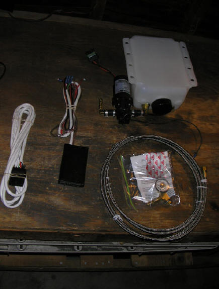

The SMC kit as purchased from No Limit Motorsports
The Aquamist DDS3 kit

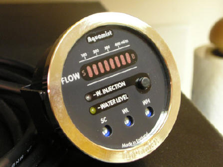

This is what you will interface with as the driver, a nice monitor that fits in any 52mm gauge pod

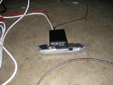

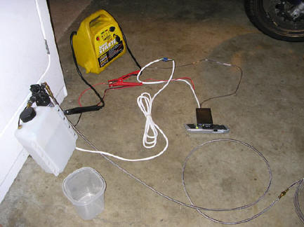

I started out by doing a dry run of the SMC kit on my garage floor. Just to make sure everything worked fine before getting installed. I used tap water for this test run.
I used a 12V jump-pack to simulate a power source from the car. It's hard to see but the red light for low methanol is on, there was no water in the tank.

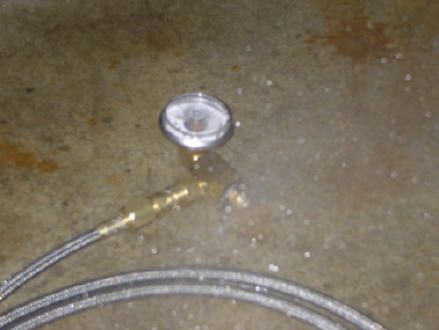

Here you see some water in the tank and no more red light...float switch works...check!
A pic of the nozzle spraying
Another pic of the controller

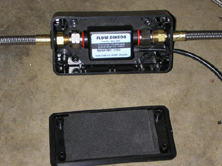

Here is where I decided install the DDS3 flow sensor. The SMC kit comes with 2 lengths of braided steel line to go from the tank in the trunk to the nozzle in the intercooler pipe...a perfect place to put a flow meter inline!
Just taken apart

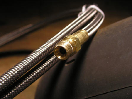

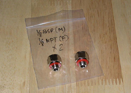

Here are the ends of the junction. I was kind of intrigued as to why the SMC kit has flare fittings on the ends that connect to the tank and the nozzle, but just standard 1/8 NPT fittings for this center junction. Not really bad, but I would have used flare fittings. No worries, as Richard came thru with some adapters to the 1/8 BSPT of the flow sensor
The adapters...keep in mind that getting the right ones are critical. I probably wouldn't go to a local hardware store and jamb something in there. These adapters aren't very common so you might be tempted to just make something work. However, the flow snesor body is plastic with plastic threads and it can be damaged very easily. Just do the right thing and get whatever adapter you need from Richard. He has the ability to pretty much make whatever you need, so whatever kit you integrate this with, be sure to vocalize to him exactly what you need and he'll hook you up...you'll be glad you did.

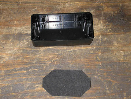

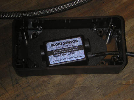

The next few pics are of some parts I used for the flow sensor. Now...this is a step that I totally decided to do on my own and is not really "necessary". My thought process was...this flow sensor will be underneath the vehicle exposed to the elements, so why have it in the line of fire? I got pretty creative and got parts from various places, mostly Radioshack to design an enclosure that would protect the flow sensor. Above is the actual case

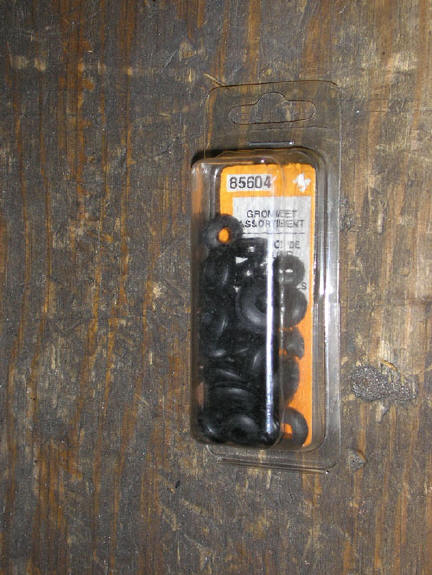

Some random grommets I bought for various duties, in this case, I used some for the enclosure to get a good seal around the steel line exiting the enclosure
This is a grommet around the flow sensors 4-wire wire harness that also has to exit the project enclosure

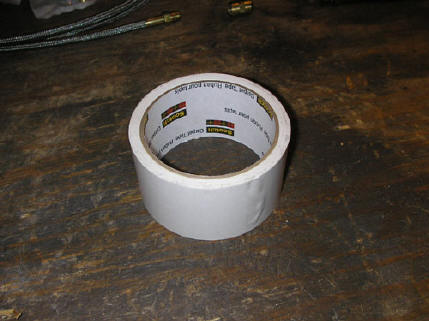

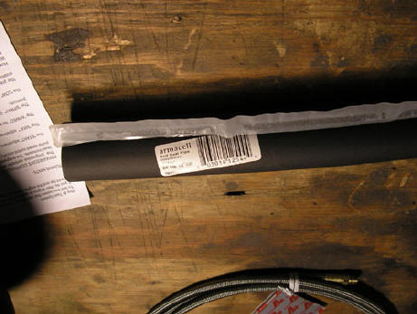

Some foam padding I bought at the Wal-Mart arts-n-crafts section for about 78 cents a sheet. It has sticky back so you can stick it anywhere. I have used this stuff in so many different projects for my various cars and bikes...very handy stuff to protect against minor scuffing and the like...
All the above pics show the enclosure with the foam padding inside. I had to install some padding then place the sensor inside the enclosure to see if it was a nice fit. Notice on the lid of the enclosure I used 2 layers. This made it so that the sensor was completely still and didn't vibrate while inside
The first hole and grommet for the 4-wire wire harness

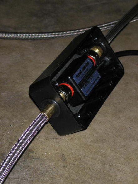

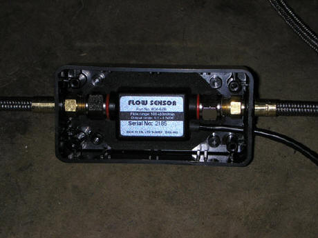

The flow sensor actually in the enclosure with the wire part done
Installed the adapters and beginning test fitting of the steel lines and where to drill the next set of holes for those lines coming into and out of the box

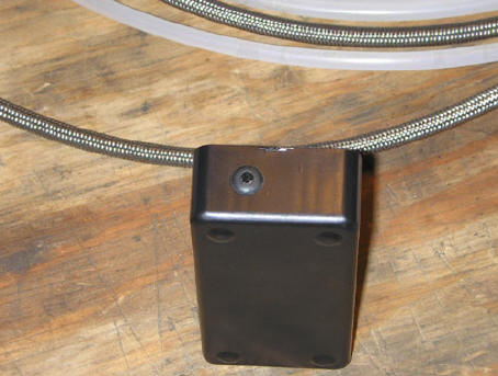

Above are the pics of the enclosure completed. Keep in mind, when you finally installed this thing in the system, there is no distinction which way the methanol flows, so it doesn't matter how you installed it. It will measure flow correctly in either direction
Closed up and sealed up. At this point the enclosure is exactly midway between the 2 lengths of steel line

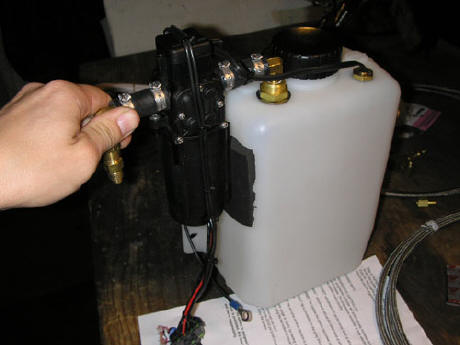

Now, onto something else I wanted to do. My goal here was to minimize any vibration from the pump while it was running or even while it was sitting in the vehicle due to normal driving conditions. Another thing I noticed about the SMC kit was that the pump kinda seems to flop around against the sides of the tank due to it not being secured to anything other than a short section of rubber hose. I know I'm being extra picky here but I like to look very far down the road and take into account any possibilities. I needed to acquire some foam padding that was about 1/2" in thickness. The above mentioned wal-mart stuff wouldn't cut it here, too thin. I know there are other places that you can source this from, but the only thing I could find locally in the correct thickness and "sponginess" was some foam pipe insulation I got from Home Depot. Seeing as I only needed a very small piece, I could make this work
Some double sided tape to stick it to the tank
Here is where I placed it...
Installed...now it looks crappy in this pic, but I didn't take a pic after I cleaned it up. The edges shape nicely with some sand paper, so I managed to get the edges of the foam to look pretty good with a few strokes of 100grit

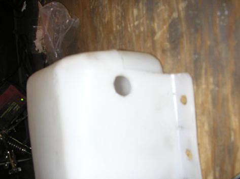

The SMC kit has a float switch already. The way that SMC has it set up is, once the float gets to about 1/3 tank leftover the red light on the controller lights up to warn you "hey...you need methanol"...It is left entirely up to you to fill the system as once it runs dry, there is no safety feature to protect against an aggressively tuned map running out of methanol. I had originally intended on just using this float and tapping into the signal wire for the DDS3 instead of running a whole other float switch and more wires. Now...the Aquamist system also utililizes a float switch with a different design but ultimately serves the same purpose, HOWEVER, when the DDS3 notices that the float is energized, instead of just warning you like the SMC, it cuts the boost solenoid. This is great, right? Well, not so much...as I originally used the SMC float, the DDS3 would cut me down to wastegate pressure every time I got down to 1/3 tank...effectively making that 1/3 extra methanol useless and required me to fill up that much more often. Not fun after about 3 fill-ups. My only remedy was to installed the second float switch ( which comes with the Aquamist kit, btw) extremely low in the tank. Now, I actually have a warning light AND a boost cutout when it gets to the bottom if I decide to ignore filling my tank when I see the warning light up.
The above pic is of the new hole needed for the Aquamist float switch
Here you see the switch installed and ready to go. It is very low in the tank so that I can get maximum usage of my methanol. You can also get a peek of the cleaned up edges of the foam padding I was talkin about earlier

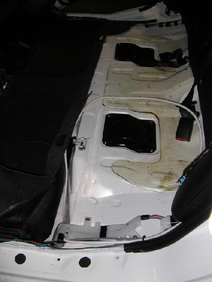

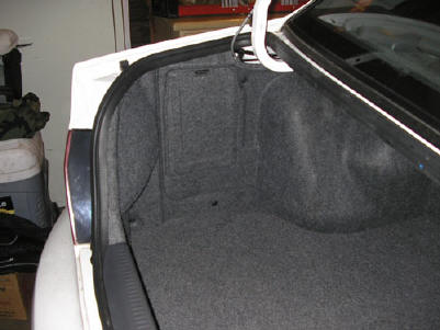

No, onto the trunk mounting of the tank. here the trunk is cleaned out of all the upholstery and ready for the tank
Notice I took out that little black vent thingy to make a little more room for the tank

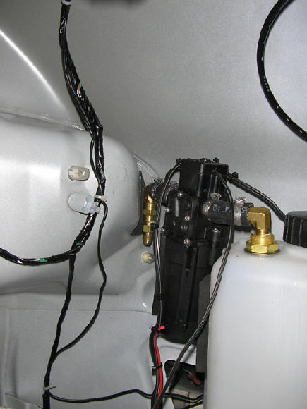

Here is the tank installed in the trunk
If you notice here, the actual location I have then caused this part of the pump output to touch the body of the car. Loose metal to metal is never really good and I did want to keep the chaffing and rubbing to a minimum...sooooooo, another great use of that 78 cent foam paper....
Sanded down part for grounding of the pump
Pump grounded...

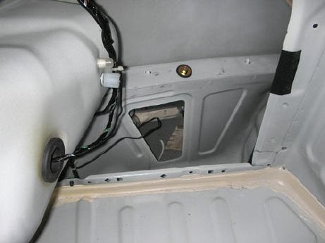

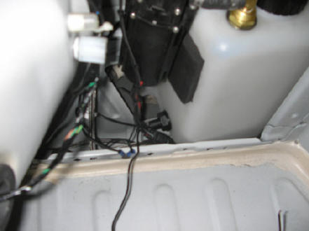

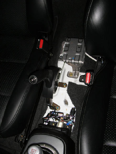

Routing of the SMC tank wire harness. I brought in so that it can be brought out of the center console, which is where I put the controller
Here is where the SMC wire harness comes out at
Another angle

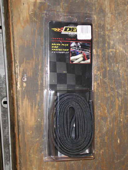

Okay...just another shot of some parts I bought to make a clean and safe install...you can never go wrong with wire sheathing...I like this stuff because you can cut it and the ends don't fray or come undone. It's a bit more pricey though. I got it from a custom car shop locally
The SMC wire with the sheathing around it. I used it here because there are some sharp metal edges that MAY cause the wire to get chaffed in the future...

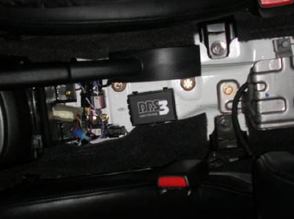

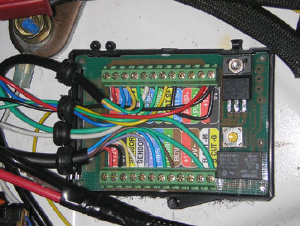

Here is the brain of the Aquamist DDS3 system
The brain opened...

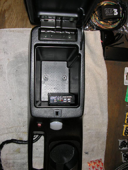

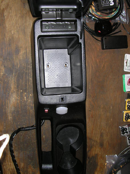

Okay, here is the center console box that will house the SMC controller...
Drilling of a hole to run the controller wires thru...
Using more of the Velcro, the final resting place of the SMC controller...

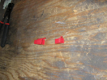

Well, I am a fanatic of clean installs and I love to use disconnects whenever possible to make future maintenance easy. I got everything I needed, to included the crimping tool from here:
http://www.electricalconnection.com...nts/hitachi.htm
Now, I had the crimping tool already because I frequently use these connectors for many other projects, but I still don't think it was too much to come out of pocket
A 4-wire connector

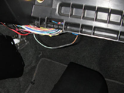

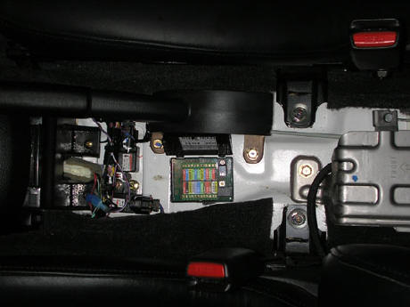

For those of you who have an XEDE, here is that boost wire that had to be pulled out of the ECU harness and reconnected to the XEDE harness
Here it is cut and I put the 2-wire green wire in line. The reason I used opposing male/female ends is...if I ever want to disconnect the system for whatever reason...all I have to do is take the green wire out and connect the brown wire back up to the original green wire
The green wire is from the boost solenoid. Since it took me some time to install this kit and I had to use the car daily, I just brought the wires into the center console, but tapped them together for the time being. This kept solenoid from being cut off. Basically, the way the DDS3 works is, the boost solenoid wires are run in series thru the brain box, which contains a normally-open relay. If there is any trouble from the meth kit, it basically opens this relay, disconnecting power to the boost solenoid and bringing you to wastegate pressure

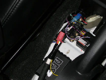

Okay, next item...here is a wire that provides the 0-5V signal I was talkin about earlier. I was originally going to install it with the XEDE until I realized that all the analogs where taken up. But here is a nice shot of the wire with the XEDE style pin installed. If you have a different EMS, this will not pertain to you
A close up...

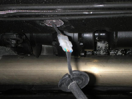

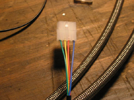

Now...onto the wire harness of the flow sensor itself. Like everything else, I'm a fanatic of quick disconnects. Here I am splicing a 4-wire disconnect to separate the sensor from the brain box underneath the car
The female connector...
The male connector...
The 4 wires of the flow sensor with the terminals that insert into the connector
Step 1...
Step 2...cleaned up with heat shrink tubing
Just a shot of the other end...repeat of the previous process

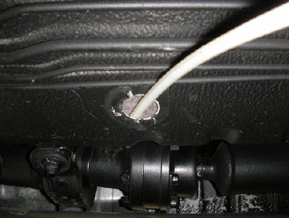

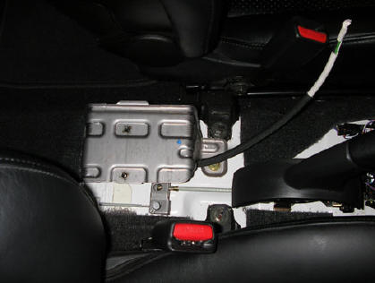

This is the hole underneath the car that I went thru. It is a rubber grommet that just pops out. It's roughly underneath the drivers seat

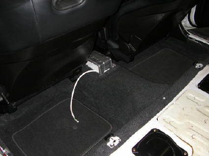

Using a large zip tie as a snake, this is where it pops out at inside the car

Okay, back to the 4-wire connector of the flow sensor. I made sure to route the wire in a way to get it to the other end, but keep it out of the way. I used more of that sheathing on this part of the wire because it is exposed to the elements. To get it to fit in the middle of the grommet, I just made a slice
Installed under the car and complete

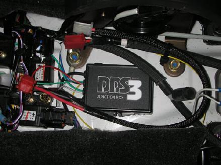

Here are some pics of the brain box actually wired up
A close up
Finished product...

Here is the gauge pod housing what I needed. Just a word on the top gauge. It is no longer there. It was a water pressure gauge but it was more trouble than it was worth and didn't really tell me anything I cared about. What is not seen in this pic is a small LED on the left side of the Aquamist gauge which is the extension of the SMC LED warning me when the level gets low
