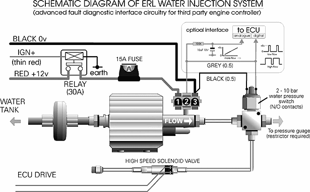

My question is on wiring though, on the Aquamist wiring diagrams i've seen so far you have the MPS connected to ground on 1 side and a third pump input on the other.\
I have wired the MPS with ground one side and the other to the pumps ground input but the pump does not turn on.
How should i connect it?

This system has worked great so far, but i have purchased a Aquamist Single channel manifold, (erl.806-201).
My plan was to fit this close to the HSV, i will then turn up the devils own pump pressure cut off switch so that for normal running the Aquamist manifold will turn the pump on and off depending on the pressure.
Basically i'm wanting a system like the one shown below, but with a Devils own pump.
My problem is though the Devils own pump has only 2 connections so how do i wire up the Aquamist Manifold/pressure switch?
