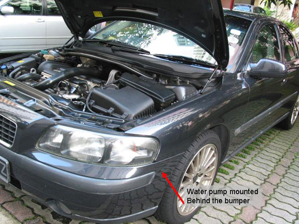

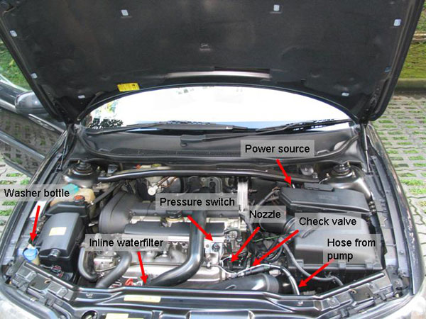

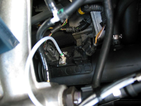

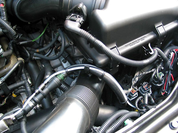

These are the pictures of my installation, done by Gan Motorsports
my car is a Volvo S60T5 MY2001
have mounted the high pressure pump behind the front left side the bumper
(my car is a RHD), drawing water from the windshield wiper tank.. the
pressure switch is mounted for easy adjustability

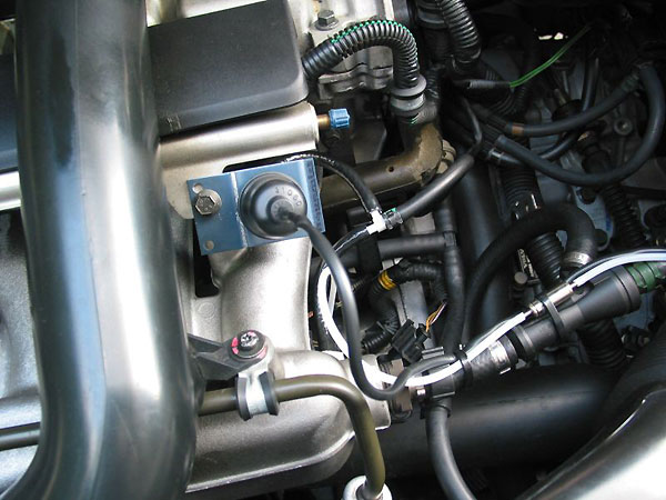

and the nozzle is actually drilled into the plastic intake air tube, bet
the temp sensor and the boost sensor; mounted with a small metal plate
secured with rivets and epoxy bonding

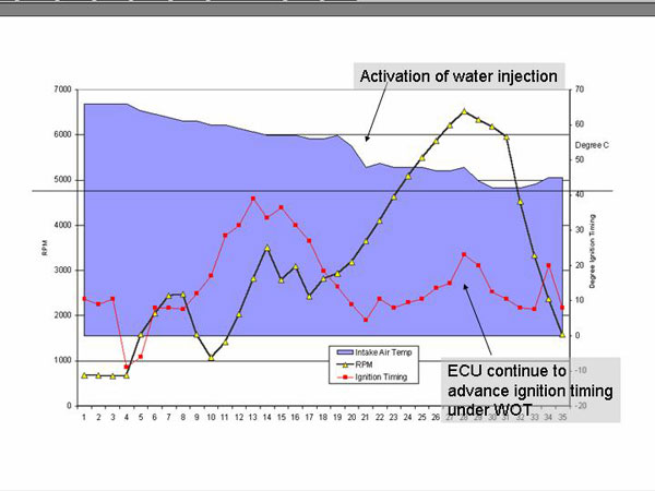

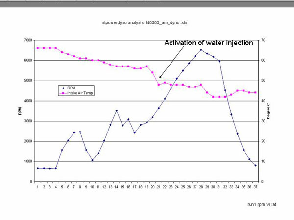

I have just receive a few more interesting plots during the dyno session:
the graphs were recorded during a dyno run;
ambient temp was 32 degrees C, humidity 85%
See the inlet air temperature drop when water cuts in...
The ECU is able to alter ignition timing in present of WI...

Did he sent an diagram without the water injection activated? Would be nice to see. Where are those temps recorded, after throttle, or ...?
What turbo pressure?
Gert
Old 19-05-2005, 04:05 PM
I did ask the same question but I was told that the car wad mapped with water injection he will not risk running the engine without water injection.
Nor sure wherethe temperature sensor was placed. Data was recorded with ODB2.

Geez, that is something.... timing from 5? to ? 23? :shock: :shock: :shock:
Too bad we do not know the boost levels at what rpm....
Gert
