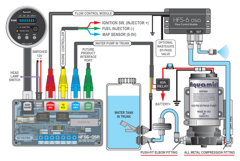

Default HFS-6 fittings issues...
A number of systems installed have experienced line leakage, on further investigations we have found the wrong fitting has been used on the pressurised side of the pump. The user manual has shown an "incorrecty" drawn diagram showing a "push-fit" fitting is used on the output side of the water pump (on the 5-port manifold).
Here is an updated diagram, with components marked in red.
