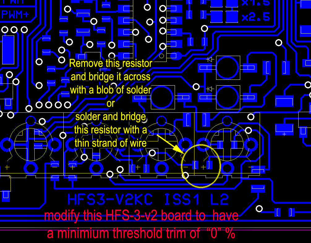

I just installed my hfs2 aquamist system.
Now, I've got bigger injectors and so the injection system doesn't seem to start until atleast 3k rpm even with the threshold set at minimum. Does anyone know what resistor mod needs to be done in order to make the threshold limit 0%?
A diagram would greatly help. Thanks.
