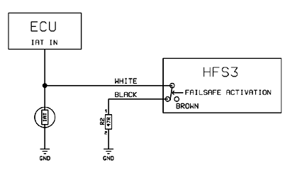

Thank you for the response Richard! I see no way around cutting the tan IAT signal wire however. Attached is a logical diagram I created based on your suggestions. I see this being viable, although determining the correct resistor value may be a bit of a challenge. Thoughts?

Here is a diagram that may work well. I suggest trying a 47ohm resistor first
Thank you Richard. I'll give your method a shot since it does not break the direct connection between the ECU and the IAT sensor.
