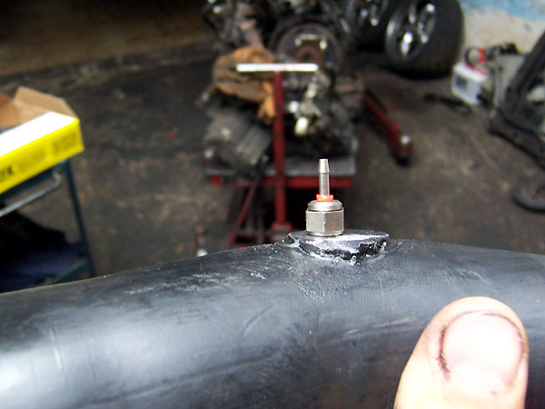

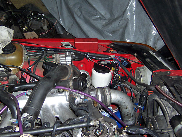

Default I have a 2c system in my 1985 900 turbo
It's nice to see someone on this site with a classic SAAB!
I'm running a 1.0 mm jet that sprays into the outlet tank of my intercooler. It's controlled by a HSV which is tapped into the fuel injector wiring. I'm running a lot of extra boost and my timing is up to around 23 BTDC so far. I'm injecting washer fluid rated to -20deg. F, so it's about 35% methanol.
