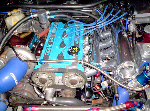

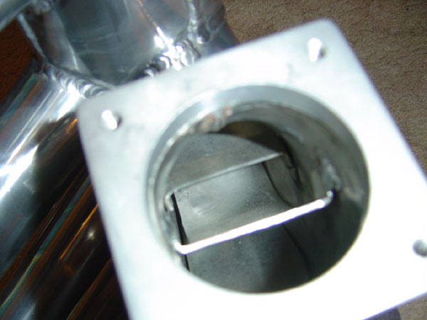

Thanks for the interest in the video. The intake manifold has a center entery in the middle of the plenum. Richard has some pics that he can post as i dont know how to post the pics. The "elbow" leading into the centre of the plenum has 3 dividers in it that were tested on the flow bench to give even air flow to all Cyl. Yes the "sight glass" is on the end of the plenum.
The WI point is approx 250mm before the throttle body so what you see in the plenum is AFTER the water has travelled approx 350mm and then done a 90 Deg turn up threw the elbow before it hits the sight glass that is on the end of the plenum. Also i was using straight water only.

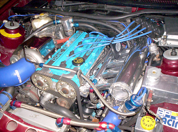

Thanks for posting the replies.
I have the following pictures re-size to show your inlet manifold and engine bay.

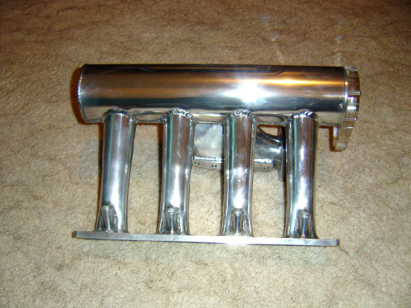

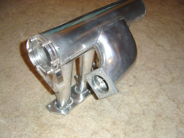

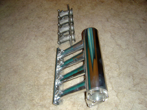

More pictures of the inlet manifold after editing. Jake will explain the effect of the extended induction pipes.

Hereare some more very interesting pictures -The length of the induction pipe has transformed the power output, I will let Racemap tell you the power difference...

Firstly, i can not accept credit for the fabrication of the Intake manifold. It was designed and fabricated by a good friends of mine Jim, he fabricates most types of Int/Exh manifolds from his company MENTAL PERFORMANCE FABRICATIONS located in Sydney Australia. Jim is also responsible for fabricating my Exh manifold too and as you can see in the video it copes well in extream conditions.
I take full credit for the programming of the ECU as this is what i do. As can be seen in the pics, the new Intake has over double the runner lenght of the standard Cosworth item. Not only does this increase air speed it also has the added benefit of having a larger volume within the runner. What must be remembered is air DOES have mass and trying to fill the Cyl as much as possible in the small time frame the Intake valve(s) are open is one of the many keys to making gains in Hp/Torq.

Also this is backed up in an unusual manner by the factory idle control solenoid. As you can see in the pics, the solenoid is attached to the throttle body and was not affected in any way by the install of the new intake manifold. The solenoids "settings" were NOT touched in the ecu software.
What we found after fitting the manifold was, the Idle contol solenoid struggled to maintain a steady idle. It would idle between 1200-1300 rpm. Obviously the new intake manifold had made the solenoid MUCH more sensitive to the air it would bypass. The cure was to fit a 4mm "restrictor" within the solenoid and the throttle body and this gave us the stable idle (880rpm) we had prior to the new intake manifold being fitted.
