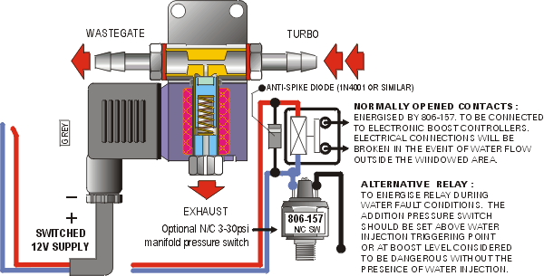

Old 24-06-2004, 08:56 AM
I am not sure how mechanical boost controller is constructed, if you could explain how it functions, I will try to devise some electronic/mechanical interface device to make it work with our output.

But is there any way to switch boost to a lower pressure, if the water injection system shuts down or detects a fault?
Take a look at this :-
http://www.machv.com/turxsdualmec.html
Someone has clearly built a electronically operated two-way gate to switch air-flow between either of the two mbcs. Couldn't we go one stage further and have three of the grainger valves that 'charged' is talking about. One for high boost and one for low boost that we can switch from inside the cockpit and a third one that would open automatically downline if the water injection suffered a fault reducing boost to a pressure that was safe without water injection.
If anyone could get me parts numbers, I'd give it a go but I can't find the electronic switch valve anywhere.
Paul.
Old 26-06-2004, 06:24 PM
Here is a few possible arrangement for the boost valve:
Here is how the boost valve works

Could you build this system to work with a manual boost controller? And if so could the 'default' (i.e. what the system reverts to in the event that a fault is detected) be set at say 0.9 bar.
Paul.
