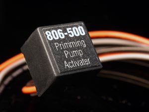

If you already have an accumulator, 2x 0.6mm is effective. Possibly a push pump will increase the efficiency of your system by a good margin, Here is a picture of the priming pump relay driver, currently available (not updated on the website), part number 806-500.
I don't think you need it until you move to 2x0.7mm and beyond.
