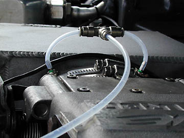

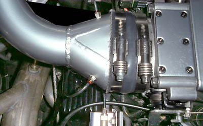

I have had two encounters two syclones (both on our Gallery), one is running a few pounds over stock and the other ... about 800BHP.
First the 800BHP, 10s syclone runs twin-aquamist pump:
http://www.syclone.org/
Russel Bland runs sustem1s with two 0.5mm nozzles.
http://www.syclone.freeserve.co.uk/
They both get results in different ways. The Guy that runs 1.3bar boost should use at least two 0.6mm jets giving approximately 330cc/min or go for a twim pump system - up to 600cc/min, more with an accumulator [/img][/url]
