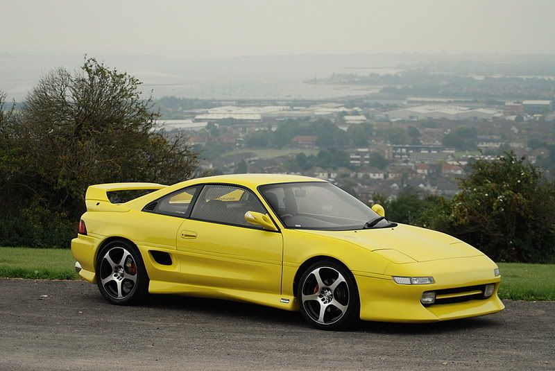

I have TRD Supercharged 3.0ltr V6 MK2 MR2. It's got a TRD roots style supercharger and the 3ltr V6 is out of a Camry. Pics.....
