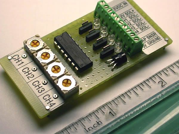

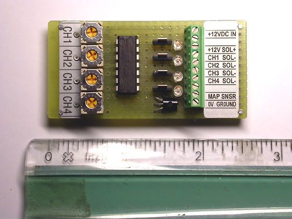

Old 22-11-2007, 01:02 PM
We have a highspeed valve that might be able to fit your application, It takes 1.8ms to open amd 1.8ms to shut.
Alternative option - a 3-stage system (CH-1 to activate the pump relay):
Please the link below:
http://www.srtforums.com/forums/show...=388723&page=3
