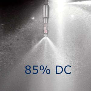

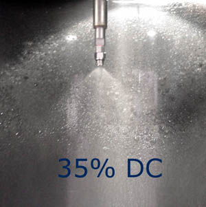

Old 06-03-2004, 12:20 PM
In order to get a reasonable injection pattern at low flow, you need to fix the jet directly onto the HSV with zero cavity between.
We have this set up at every show and the spray was very resonable even at 35% DC. (0.7mm jet) pressure was set at 8 bar.
See images below:
