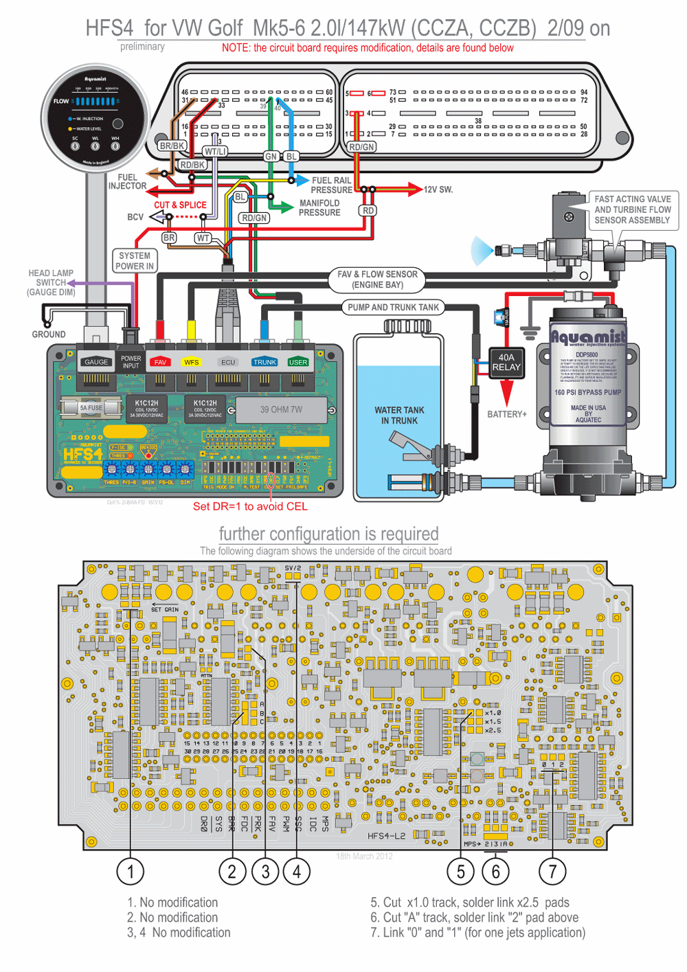

Default VW Golf 5&6 (TFSI)
Golf GTI Mk5/Rabbit (A5/Type 1K 2004-2008) 2.0 TFSI (200PS) ............... (BAW/CAWB)
Golf GTI Mk5/Rabbit (A5/Type 1K 2007-2008) 2.0 TFSI (230PS) ............... (BYD)
Golf Mk5 (A5/Type 1K 2005-2009) 1.4 TSI (120-170PS) ............... (CAXA/BMY/CAVBD/BLG)

Would this diagram be applicable to an a4 fsi?
Old 19-03-2012, 08:17 PM
Default Re: VW Golf 5 (FSI)
I am not sure. does the ECU look like the on eion the a4?
I want to make a A4 wiring diagram but I do not have a ecu pin out info. If you know I can find them, please send me a link [richard@aquamist.co.uk].

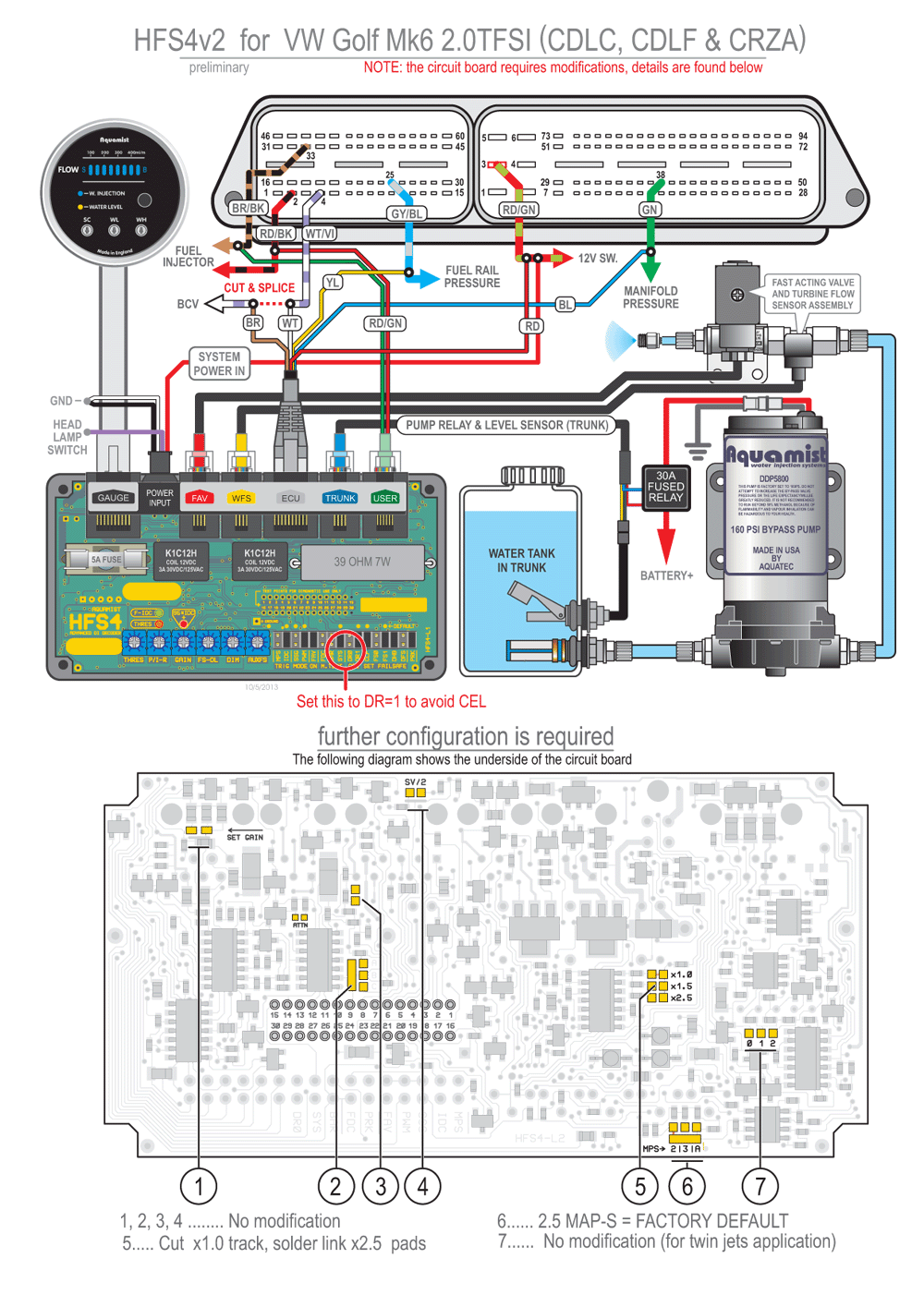

Default Re: VW Golf 5&6 (TFSI)
Hi Richard, Can you please post up a wiring / ecu pin out for VW 2.0 FSI with engine code CDL - fitted to 2012 VW Scirocco R?
I am connecting up a FRC HFS2-v2 to my car. Your help will be most highly appreciated.
Thanks.
Old 18-05-2013, 08:54 AM
New CDL- wiring drawing posted.
Hey guys.
My engine on the US Golf R is CRZA...wondering wich diagram is applicable to my platform?
