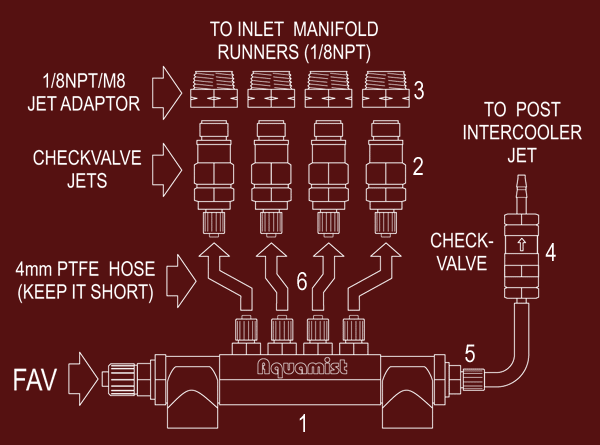

I will get 5 Nozzles 0.4mm with 110cc (I think B type nozzle in 0.4mm). Then, I will need the following?
I have a question...the inlet Port diameter 4mm / 6mm which is exactly?, sorry, but I am new in this world...and I want to play with Aquamist and my car..
And...the kit is:
Package contains:
- Multiport hex manifold -----------------------------------------------OK
- Checkvalve jets with compression fittings --------------------------These are the 4 nozzle of 0.4mm type B?
- One 1/8 NPT jet adaptor (one per cylinder)-------------------------OK
- One checkvalve for post IC jet --------------------------------------This is the nozzle for the post IC...is another 0.4mm Type B?, or I have to buy the nozzle?
- One 4m to 1/8BSP compression fitting (hex port + 1) -----------What is this exacly?
- 4mm high temperature PTFE hose----------------------------------OK
Thank you.
Old 20-03-2016, 01:56 PM
Default Re: Direct Port EVO IX rs HFS3
- Direct Port bundle: Type B is 110cc/min. x4 (806-501B)
- System comes standard with 3 nozzles, choose one of them a type B (806-301B). Not need to buy
-4(mm) to 1/8 fitting. This is the fitting for the 5th port on the hex manifold for the Post IC jet. (mis-print)
See below with numerical caption:
Package contains:
1. Multiport hex manifold
2. Checkvalve jets with compression fittings
3. One 1/8 NPT jet adaptor (one per cylinder)
4. One checkvalve for post IC jet
5. One 4m to 1/8BSP compression fitting for post iC jet (hex port + 1)
6. 4mm high temperature PTFE hose
