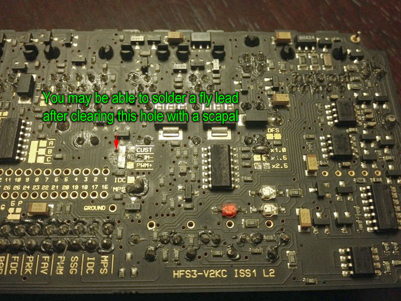

Hello,
I just got hand on a HFS3 V2KC board which was installed on a Mitsu L200 turbo diesel.
This PCB has gone thru few changes.
I would like to set it up back to factory setting (it is going on an evo3 now)
anyone would have a picture of same PCB with default setting ?
Or could you tell me what are the default settings ?
I'm pretty sure the MPS soldering has to be removed, then solder bridge IDC again (I think this has been cut)
now what about CUST, PWM-, PWM+
Then *1, *1.5, *2
thanks

factory:
MPS/IDC ........... IDC linked, MPS cut
PWM- ........... linked, all others unlinked
iDC prescaler .......... x1 linked

PWM- is well butchered, that's worry me !
I'll let you know how it goes
thanks for your help
Old 14-06-2017, 08:33 AM
Default Re: HFS3 V2KC default pcb setting
That doesn't that bad. As long as the pads are there, you will be OK. Perhaps clear the flux with methanol.

after closer inspection, the larger pad just when off the PCB just by contact with finger :/
Anything we could do to sort this out ?

Thanks Richard I will try that then.

it seems to have done the trick. the led blinks again
