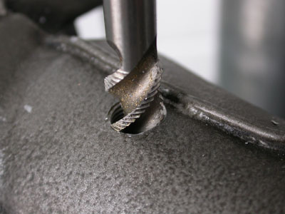

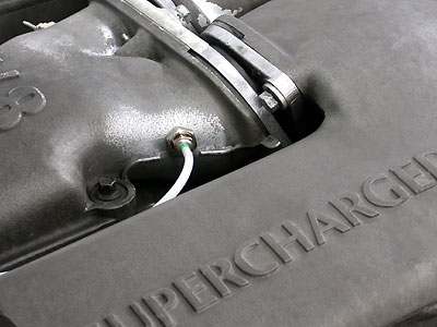

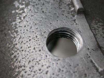

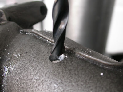

Posts: 127
Installating the jets:

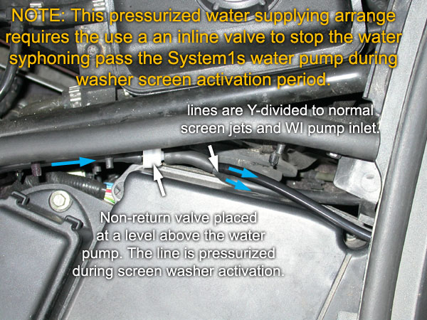

Posts: 127
If the water pump has to be placed on a level higher than the water tank, this following method may be used to assist the WI pump from creating priming problems after running dry.
In the event of the pump run dry, one can always activate the screen washer during boost to push water into the dry-up water injection pump.
You are increase the water flow if you activate the washer lever during WI.
Inline valve drive circuit:
Forumadmin
