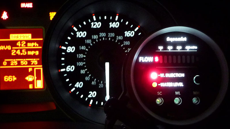

Pics of install on 2008 Evo X.
Washer fluid reservoir deleted. Tank opening accessible via washer fluid access panel (not pictured). Stealth install for California nazis.

Gengo:
Amazing how well the gauge colours matches the instrument panal in the dark!
