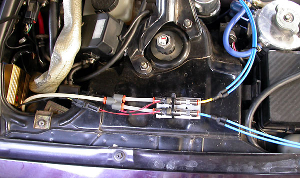

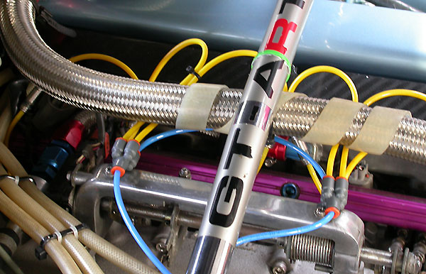

A few more pictures of the skyline - just keeping things up to date.

Purple valves are replaced by HSV (due to seal swelling):
Picture taken above of the equal-length port injection haose with checkvalve:
A close-up version of the 1:4 splitter:
