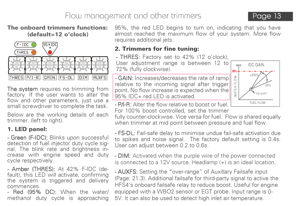

Just a quick clarification. For the gain trimmer, counter-clockwise rotation results in a larger/steeper slope per the figure correct?
  #72
Old 02-08-2017, 06:44 AM
Default Re: Mazdaspeed 3
incorrect. it is clockwise. How did you arrive at this conclusion?

Hi Richard,
I interpreted the figure on page 13 of the HFS4 v 3.1 manual as CW = a decrease in slope while CCW = an increase in slope. It doesn't actually state in the description of GAIN which direction is an increase or decrease in slope.
  #74
Old 03-08-2017, 07:52 AM
You are the only person that interpreted the diagram this way. Majority of people would rotate the volume control clockwise to increase loudness on an PA system.
The manual text (v3.1) doesn't say CW or CCW on page 13. The figure is correct, but the direction of arrows does not represent the trimmers. It is related to the two slopes lines.
