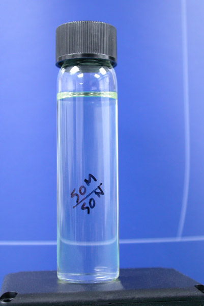

I have to assume that it was nitro because it was heavier than water, I could be wrong. I first mixed the nitro with methanol, M60/N40 - perfect mix. I then add water the same amount of water to the mix.
As more water was poured in, little droplet of oily residue began to appear and eventually it settled at the bottom (as seen). I will pipette it out and test it for flammability or check its density - I have no other means of confirmation.
Here is some more pictures M50N50 and followed by W50/M25/N25 (see the smal residue on the bottom)
