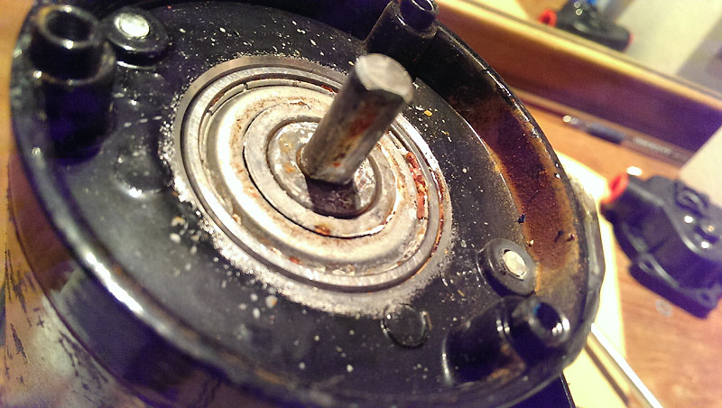

This is not as important if you have an Aquamist system. The system automatically turn off the system and activate the failsafe if the water level goes below the level sensor for more than 20 seconds. This will not allow the system to run empty and needs re-priming. A fully baffled tank also improves the risk of air entering the system. Real pain to get rid of without re-priming.
The Aquatec pump is not fully hermetically sealed from factory. There are no less than seven locations where water can enter the pump and kills the bearings (see image below).
Just considering the implcations of your comment here; what precautions
should be taken to prevent water entering the motor bearings ? Would the
effects of pump leakage be mitigated by mounting the pump vertically with
the motor shaft down ? Do you have other recommendations ?
Cheers... jondee86
Old 03-02-2016, 10:51 AM
Default Re: pump above tank
I have no solution at the moment, too many gaps. Place the tank and pump in the trunk.
If there is an internal leak, there is no salvation.
