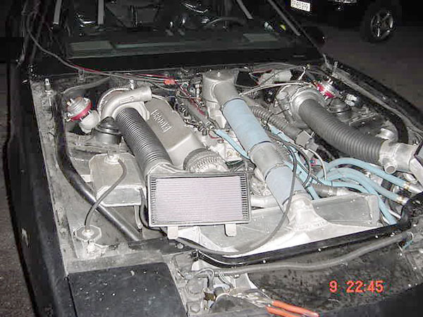

The f-body below has twin turbos with no intercooler. It is using two Aquamist pumps and by my best guess of the routing 6 jets.
Richard could tell you more about this customer's results but it was impressive. He previously had a huge front mount setup with no water injection.
Ed.

Correction, two Shurflo pumps.
The car uses 6 litre of fuel per minute and 2.7 litre of water if I remember right. Power between 1300-1500HP. Two HSVs and managed by a Autronic computer (I think) - it also has WI mapped for staging.
The Guy took away the intercooler in favour of water injection:
