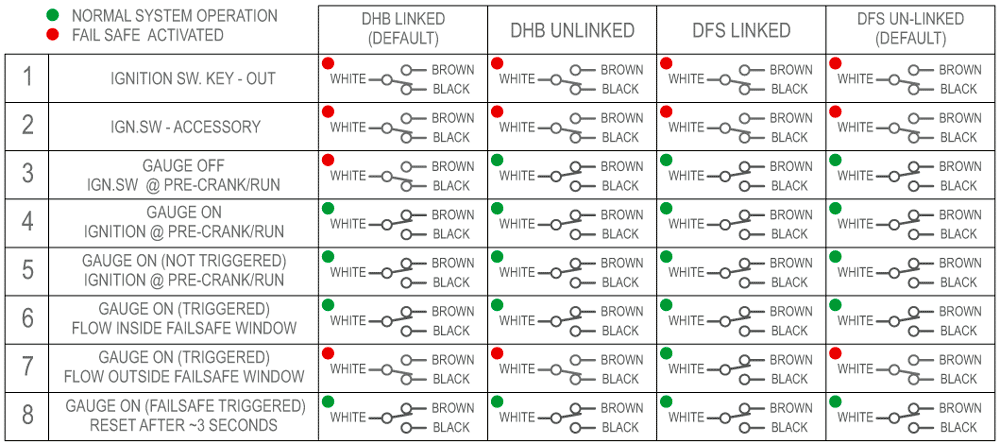

Here is the truth table of the white, black and brown. Can you check some of those contents the table

Thanks Richard. I'm not understanding the instructions. I'm not very knowledgable with electronics. What does it mean when you say white/brown and white/black? Does that mean red multimeter cable to the white wire and the black multimeter cable to either the brown or black wire respectively?
How do I test the truth table? Sorry for being so slow in understanding this stuff. I'm not sure how to tell if I'm on on normal mode or failsafe, nothing ever changes.

so basically. if you disconnect the brown/white and black wires from the chassis/ecu, and then test them you should find that:
with the gauge OFF =
OMH meter between white and black should show 0ohms or thereabouts (ie some continuity)
OMH meter between white and brown should show not-connected or thereabouts (ie no continuity)
with the gauge ON =
OMH meter between white and black should show not-connected or thereabouts (ie no continuity)
OMH meter between white and brown should show 0 ohms or thereabouts (ie some continuity)
if we can at least establish that baseline then we can move forwards.
^ all assuming you have DFS unlinked, FS0 linked?? and power to the HFS3 ...
Also FYI a reading of '0.L' implies NO continuity, it's not the same thing as 0 ohms...
