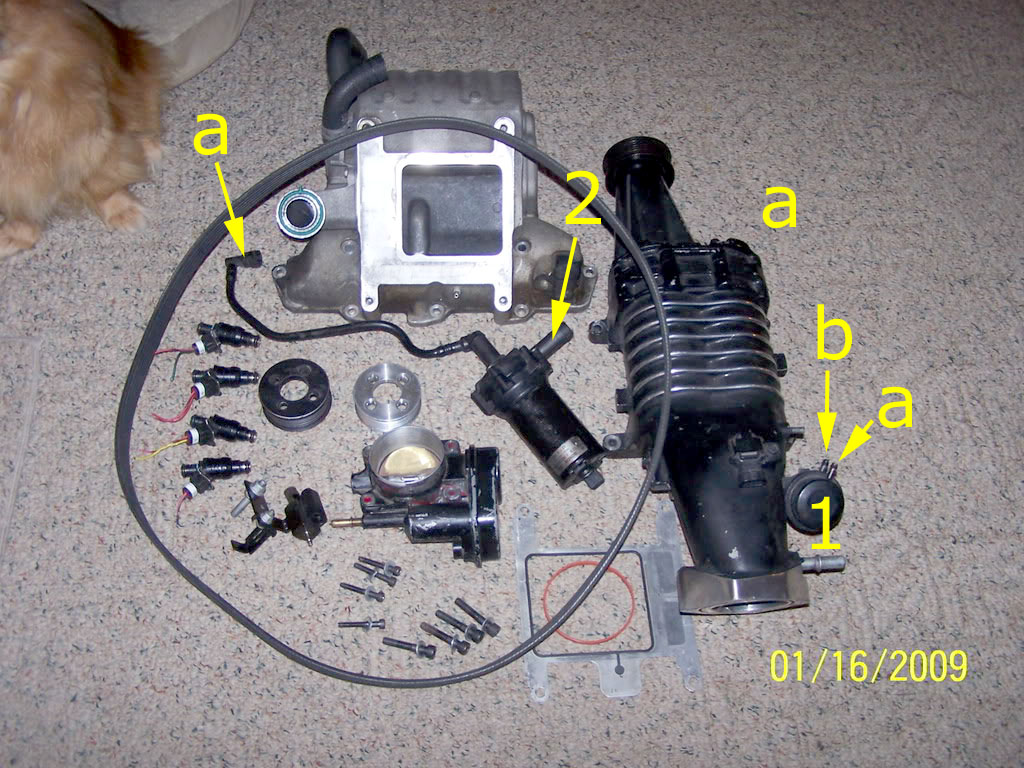

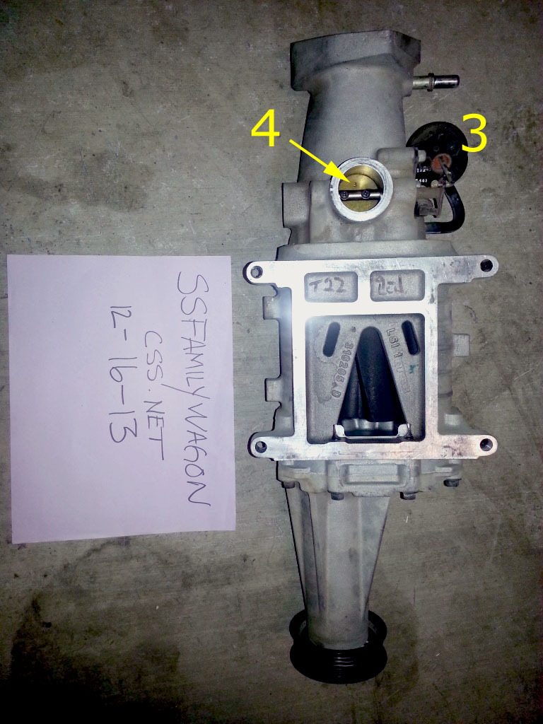

Pic 1
Pic 2
There is a solenoid on the outside of the blower(seen attached to the blower in pic 1, on the lower right side, also top right of Pic 2). It has two vacuum ports (you can see both in Pic 1), one to atmosphere and one to pre-blower vacuum. It also has an electronic connection controlled by the PCM. It rotates a plate ("valve", gold piece in Pic 2). It connects the pre-blower(after throttle body and before blower rotors) and post blower (see the blue circle piece sticking out the left side of the intake manifold in the first pic). When it opens, it allows post blower air (from the intake manifold) back up to the blower inlet (before the blower) allowing less or no boost to be made. As RPMS increase, the valve will close, allowing more boost to actually get to the engine.

3 ............ wastegate
4.............. bypass butterfly.... Shut = full boost. Open = no boost

Apologies Richard, I misspoke above. What I am reading about parts and what is happening with the pics are not always matching up. We're figuring this out together. The electronic portion is a separate piece, labeled as the bypass solenoid in the diagram. No.1 is the Bypass actuator.
Real Pic
Diagram
1a pre blower vacuum port just downstream
1b leads to the bypass solenoid, and then to the intake manifold.
2 - It's the IC pump, different circuit.

Can you take a picture of the bypass solenoid?
There should be 3 ports and a electrical connector. Let me know how many pins on the connector (2?)
Old 06-01-2014, 08:41 AM
Default Re: LSJ Cobalt/Ion Redline ECU pinout
Jeff, thanks for chiming in.
From your description of the mini, there are no solenoid valve?
There is a label (pic above) shows a solenoid valve for this set up. I just need one more picture of this part and all will be clear.
