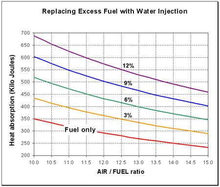

Water to fluid ratio is quite straight forward to calculate
But if you want specifically on the cooling effect due to evaporation, you need to take the latent heat of each liquid into account and re-calculate to that effect.
Some time ago I have made a chart up to show how much water is require to replace the rich-air/fuel ratio, here it is again - It was done quite quickly and do point out any mistakes plaese:

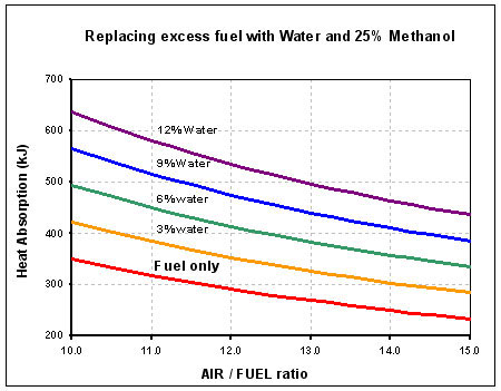

This one I have included 25% of merthanol:
Old 23-08-2004, 07:31 PM
If the chart is correct, it appears that all you need is 3% water/fuel will replace two points of afr (10-12.5).
I'd better explain how the chart was calculated:
Without water:
10Kg air + 0.95kg fuel = 10.5 afr
10Kg air + 0.80kg fuel - 12.5 afr
With water
10kg air + 0.95kg fuel + 0.00475kg = 10.5 afr + 5% wfr
10kg air + 0.95kg fuel + 0.095kg = 10.5 afr + 10% wfr
Substitude the latent heat of each liquid and plot the result with excel.
Latent heat of fuel = 350KJ/kg
Latent heat of Methanol = 1109 Kg/kJ
Latent heat of water 2256KJ/kg
