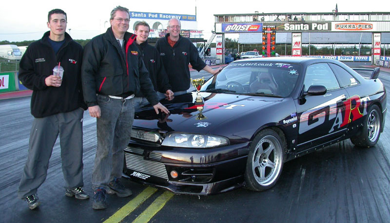

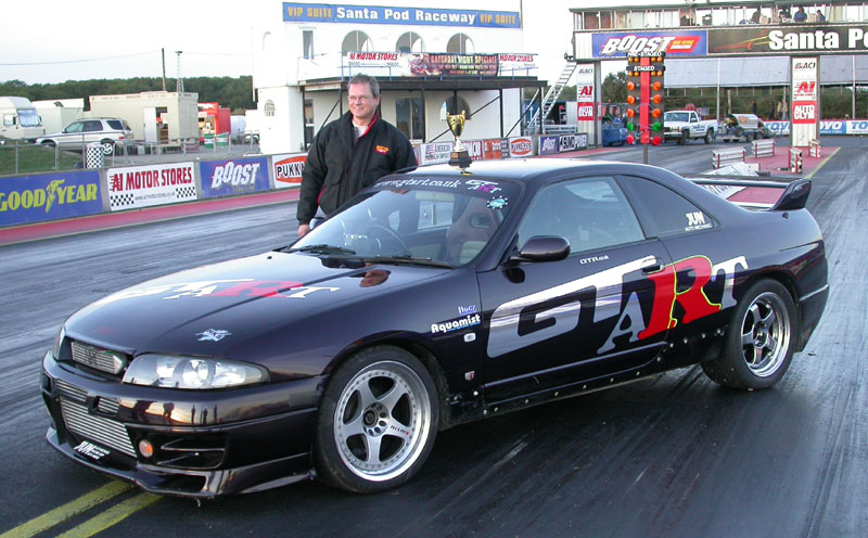

The Skyline has won the most prestigious award yesterday at Santa Pod Raceway yesterday.
The Japshow trophy brought all the top Japanese Car tuners in UK to compete in this year's final run. Intense qualifying rounds and elimination has caused a few fatalities. Brief list of line-up includes the famous Norris's awesome Evo, Alaskan's "Roger Clark tuned" Subaru, Supras and Skylines.
The final honour went to Gary Passingham's skyline who made impecable progress durng the day. His quarter-mile time recorded on the day was 10.7s, 10.5s, 10.22s, 10.078s and finally beating Roger Clark's Nitrous equipped Scooby by 1/400th of a second, clocked at 10.20s.
Here is a couple of pictures to celabrate his momentous win against all the top Japcar tuners in UK.
We will continue to help devloping this car on the water injection front. Just to confirm the a/f ratio we were running was 12:1afr/33 deg. advance.
