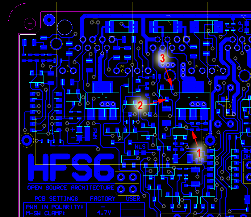

The next step. Put jumper on as below:
MPS = unlinked
IDC = linked
PRK = unlinked
TST = linked
INJ = unlinked (disable the FCM)
Please measure the voltages 1, 2,and 3. The voltage should all be over 5V. If they are, the pump relay should turn on.

1 - 2,60
2 - 2,60
3 - 3,10

This is interesting, Those voltages are too low to turn the transistor on. It should be in the region of 5-7 volts. We have some how lost some voltage somewhere on the "TST" link.
There are three possibilities this voltage can be interfered with, I can rule out two of them by:
1. Removing the gauge harness
2. Removing the Pump harness.
Please now measure location 3...

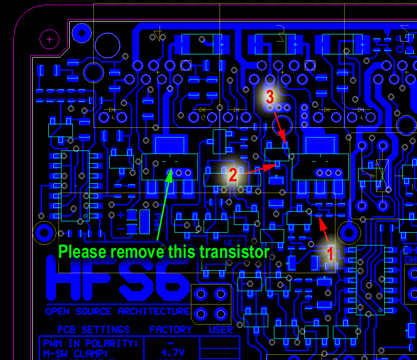

Please remove this transistor. This transistor does nothing useful. It is intended for a handheld tester but never put into production.

It worked! Finally. After removing the transistor voltage jumped to 7+V and everything is functioning properly. Thank you very much, Richard, problem is resolved at last.
So is it ok to run system w/o this transistor?
Tomorrow I will try to make a test run to be sure everything is fine.
